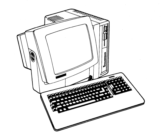

This one is a Televideo TS803 Z80 CPM System with twin 5.25 floppy and integrated monitor from the 1980's.
download/file.php?mode=view&id=677
I'll upload a real photo when it isn't in pieces.
