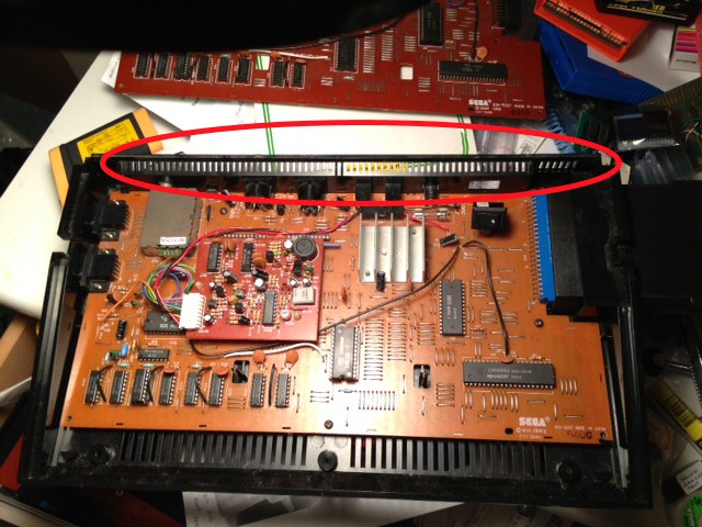

I think the easiest for a plug-in removable mod would be the venting grills on the bottom half of the case. You wouldn't be able to see the cuts from the top and you don't have to remove any existing plugs at the rear of the case. You could just about cut the venting grills then slide one of the 8 pin plastic connectors with wires through there and plug in to the SC-3000 motherboard.

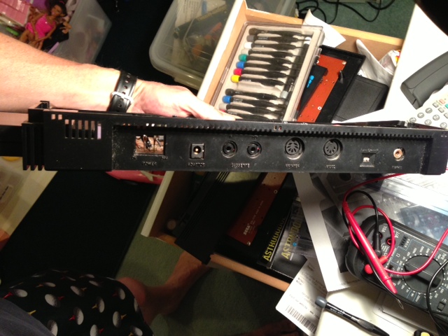

and here are the existing connectors from the rear - not much room to cut holes there

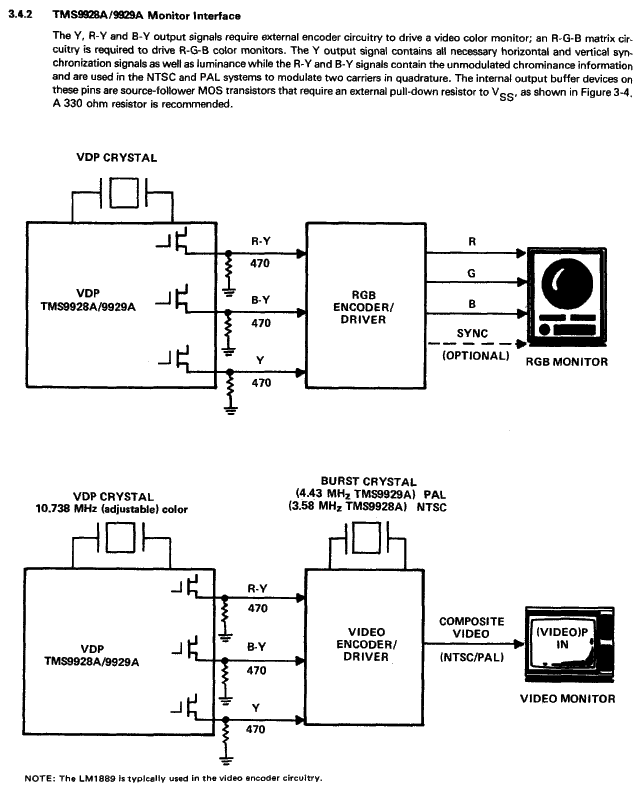

On page 3-6 of the TMS99XXA manual there is a high level diagram of a TMS9928A/29A connecting to a PAL or NTSC composite encoder with its own 4.43MHz crystal.
http://www.sc3000-multicart.com/images/ ... erface.png

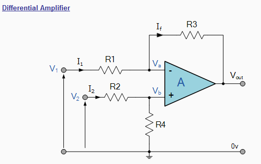

5-11under wrote:By subtracting some Y from the B-Y signal, I was able to get a signal that worked much better.
Sorry - silly question time as I'm just trying to do the background reading necessary to understand this. So are you using a differential amplifier circuit something like in the link below to subtract some Y from the B-Y signal? Where do you connect your potentiometer in that diagram to control the amount of Y subtracted? Is it the R1 / R2 feed where the Y signal comes into the differential amplifier circuit?
http://www.electronics-tutorials.ws/opamp/opamp_5.html
