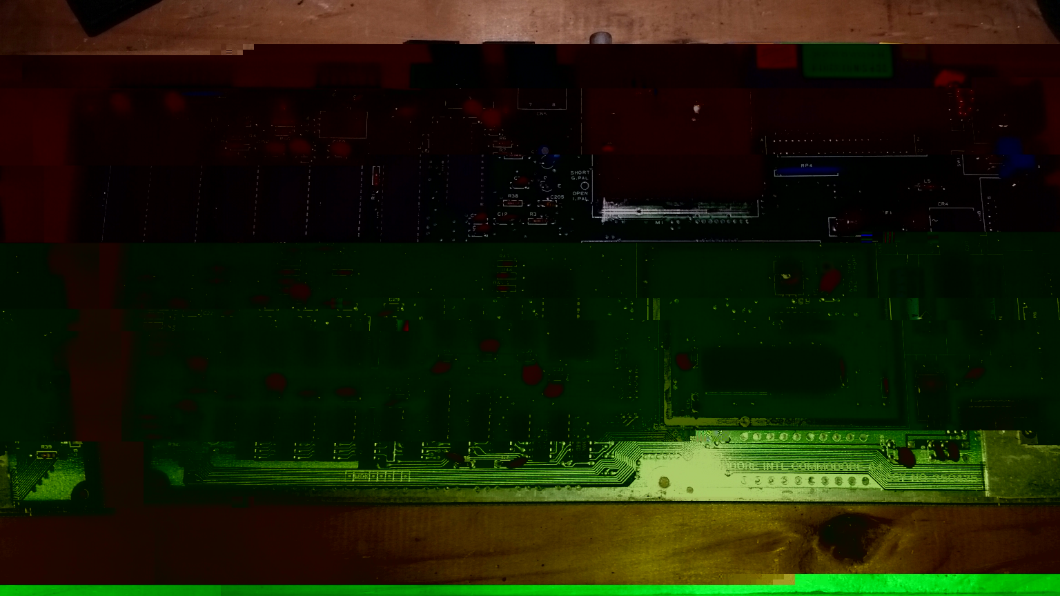

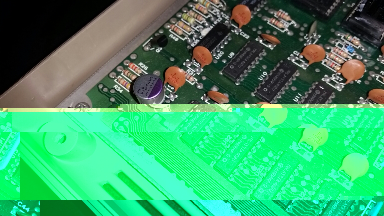

A few photos of a original C64 that I have replaced the capacitors on and fitted ex television and pc heat sinks on. The smaller caps I replaced with solid polymer units so they will never leak or dry out. The larger are good quality axial caps made by Illinois. I carefully lifted two fet/diode/regulators off the board and attached little tiny heatsinks to the back of them. I have not replaced the regulators at this stage though I have the parts to do so if I wish. With the PLA and Vic chip make sure not to use heat sinks much higher than 15mm as I found I couldn't close the top of the case with the large silver one you can see. I had to bend down the fins with my fingers and a pair of pliers. I had some concerns the heat sink paste/adhesive wasn't going to be strong enough but after a few minutes I couldnt remove the heatsinks if I wanted to! The chips just pulled out of their sockets if I tried.
Before

Polymer capacitor.
