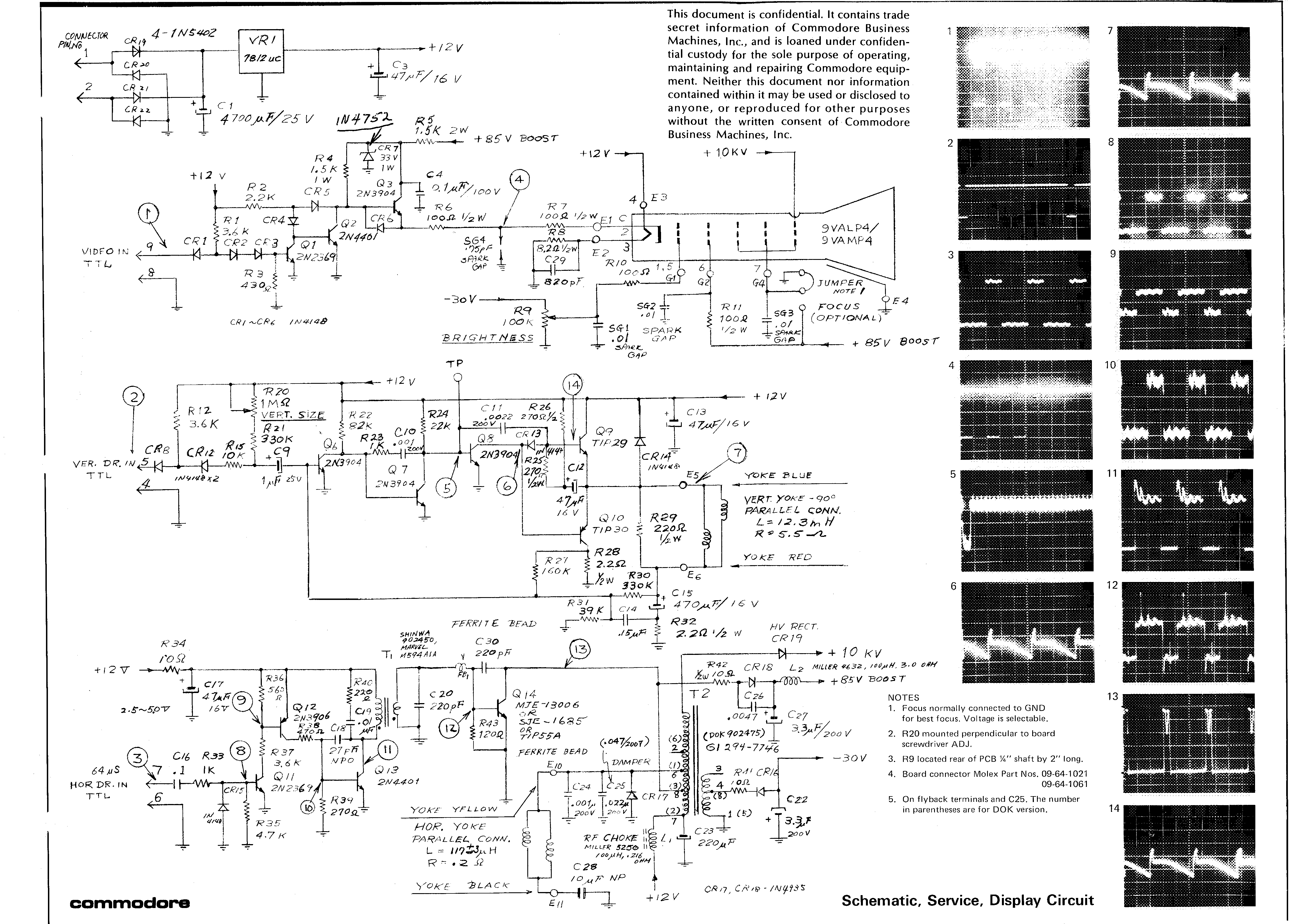

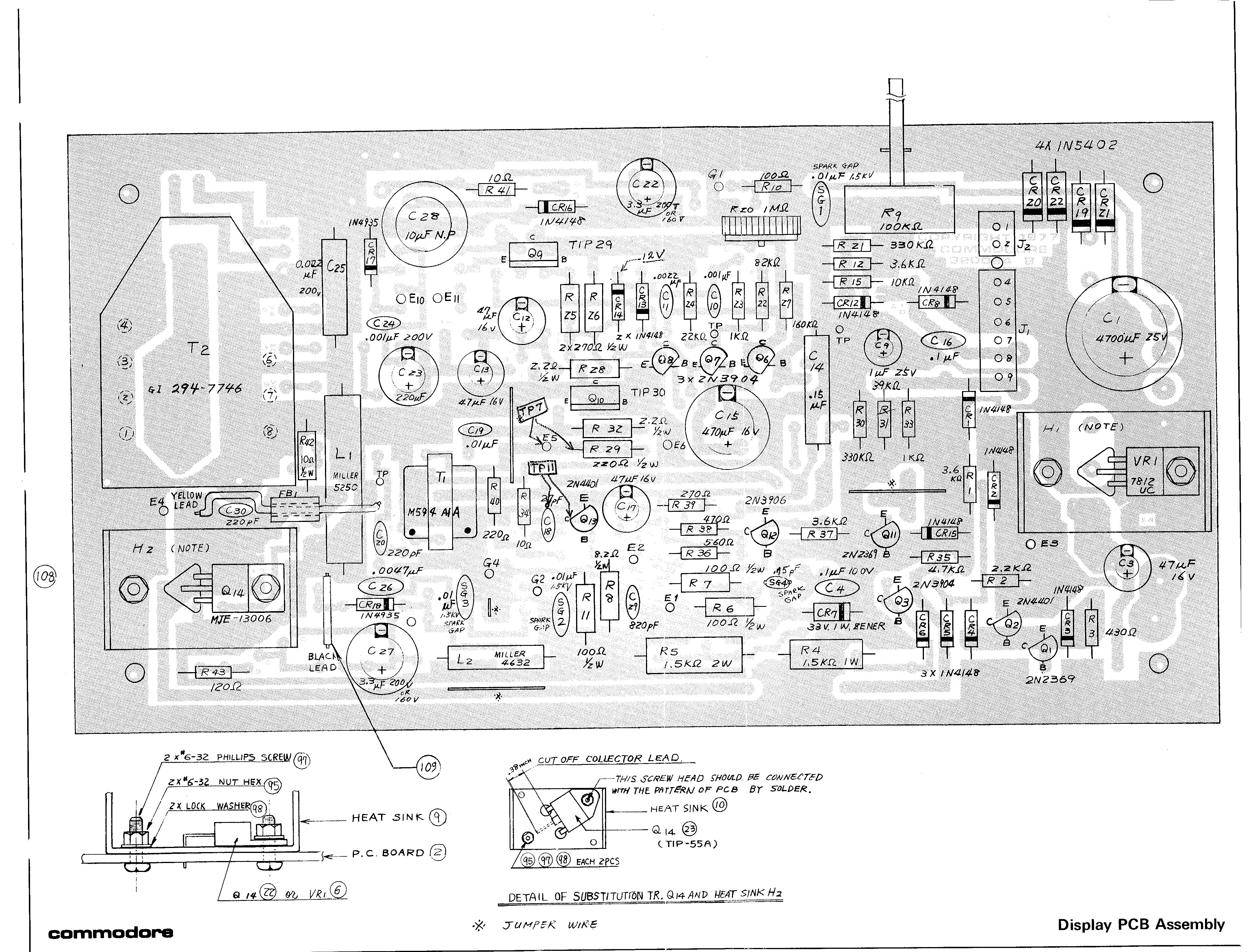

The monitor is probably worth saving seeing how it's still bright and with no burn-in, but it doesn't look like an easy task.
Although this PET is 2001N, the monitor PCB is from the original 2001:
http://www.zimmers.net/anonftp/pub/cbm/ ... ideo-1.gif
I haven't taken a photo of it but it matches this one (except all component brands are different...):
http://www.nightfallcrew.com/wp-content ... G_2122.jpg
If I'm reading this correctly, to adjust the screen alignment I need to play with the yoke while monitor is turned on (I'm not sure I like that idea):
http://i0.wp.com/www.commodore.ca/manua ... _16_17.jpg
Doing that and recapping monitor PCB would improve things but that still leaves the issue of whistling flyback. Currently silent but if it started whistling I should probably think about getting a replacement; finding one doesn't seem likely, though.
