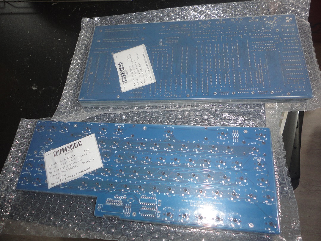

Not sure where to put this so thought i may as well put it here and let you all see the build of a new old classic PC..
it's all through hole so no smd.. i will document the build for you all to see..
Parts..
All parts were available wen i got them, some from Mouser some Element14 and rest (because of price) Aliexpress..
cost of parts was about $240 incl p&p + the $20 for the 2 boards so $260... when you look at the cost of a good expanded MSX2/2+ the cost is double+ that price and it's all new..
so i hope you will enjoy my trip in building this awesome little pc..
P.S i have another batch of 10 sets of boards coming in as sold out of last lot.
the boards
