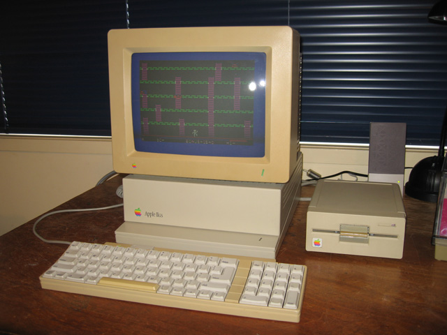

Postby tezza on Sat Aug 18, 2012 3:16 pm
Pictures or it didn't happen, right?
Here is a pic of the assembled unit but minus the mouse and 3.5 inch drive that also came with it. It's playing Apple Panic from an Apple II 5.25 inch disk. I was SURE I had some GS/OS disks somewhere but I can't find them. Not surprising really, as my software collection for my old machines is an uncatalogued mess! Anyway, I'll download GS/OS images from the web and try it out sometime.
You can see that both the screen and the keyboard need the retrobright treatment. Apart from that, it looks pretty good!
