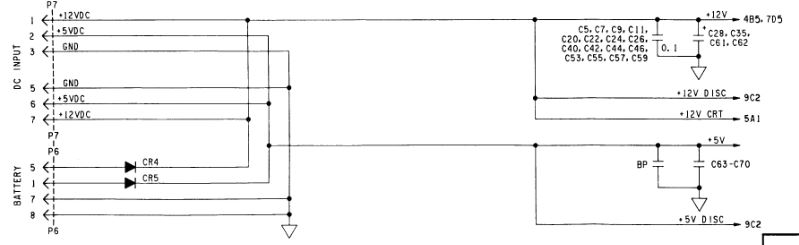

Problem - no voltage on some sections of the board. Check the schematic - R21 should be on the +12v rail, recheck - nothing!!
There are two connectors and leads from the power supply to a single plug on the board. Digging further I discover that these separate connections are indeed separate even on the main PCB.
Each of the two +5 and +12 pins feeds different board areas.
But this isn't what the schematic shows:
So maybe my older board is different, who knows, there is no indication this has ever changed in the manual. Never mind, lets move on.

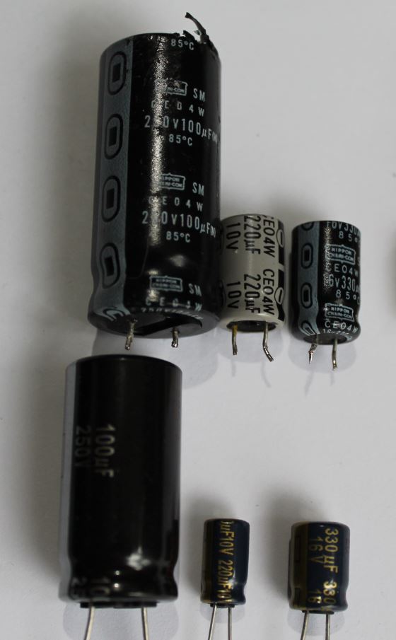

Having experienced exploding paper foil, like Tezza with his Osbourne :wink: , and not wishing to let that "magic smoke" escape from mine, I have been proceeding with caution and will replace every electro and paper foil cap in the psu.

Matching the original electrolytic's is tricky, as they are all now obsolete. I did find some data to help pick a suitable replacement, but mostly guess work.

The size difference in the modern equivalent is quite considerable.
I haven't been able to get a spec sheet for the older one to compare the rated life.

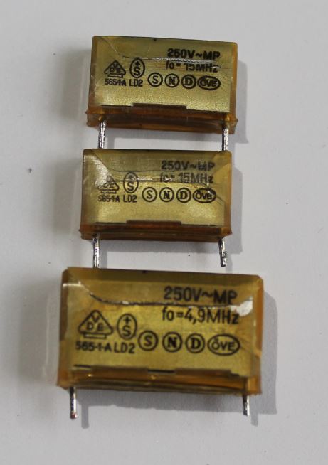

The X2 rated filter caps were definitely the worse for their age, and would have died in exciting ways.
The visible cracks are the danger sign, and have been replaced with new items the same type, and size.
