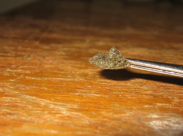

I opened up one of the keyboards today and found that the pads and contact disks had indeed degraded. The good news is this is repairable.

Postby tezza on Fri Dec 24, 2010 11:13 am
On one keyboard the keypad "4" key works
On another keyboard the "/" key works
On the third keyboard no keys work.
Here is a picture of the mylar contacts in the first keyboard. You can see they are degraded and have lost their silver. The only pad with silver left is the "4" key on the keypad (i.e. the only working one).
http://www.classic-computers.org.nz/blo ... a-pads.jpg
Here is the condition of the pads between the mylar contacts and the discs connected to the key plungers. As you can see, a pile of mush!
http://www.classic-computers.org.nz/blo ... graded.jpg
No worries as there are ways and means of repairing/replacing these.
