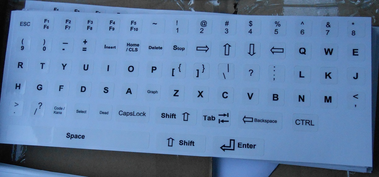

Postby LS120 on Wed Jul 08, 2020 12:28 pm
ok so the first run of see through MSX1,2,2+ labels.. commercially printed and are scratch / wear resistant so wont rub off easy, also good for the foreign keyboards to make English..
these sell for $2.50 a sheet.
key labels
